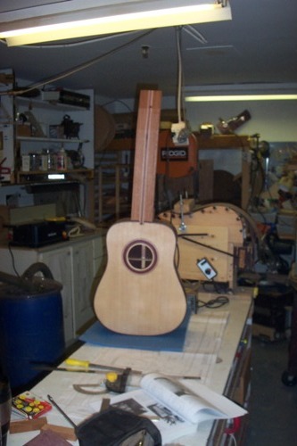

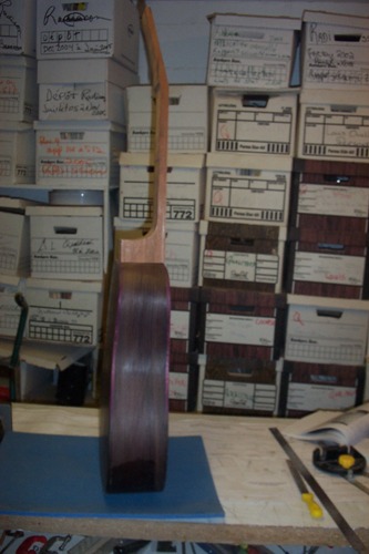

Hey folks, well, here are some more pics i'd like to share with everybody! It's really getting there slowly, here's what it looks like without some equipment!

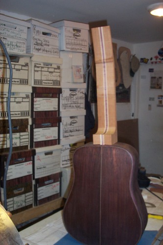

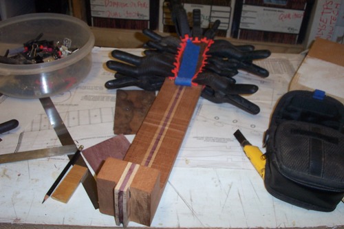

Glued the back of the headstock with some wenge veneer

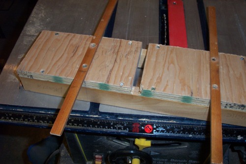

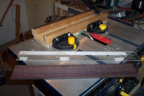

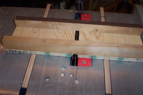

made a carrier board(good words?) to help me make my fretbord on my table saw but those thingies will be gone in the next pics, they were always getting stuck in the mitre sleds or slots? Thanks for Sylvan Wells for the great idea!

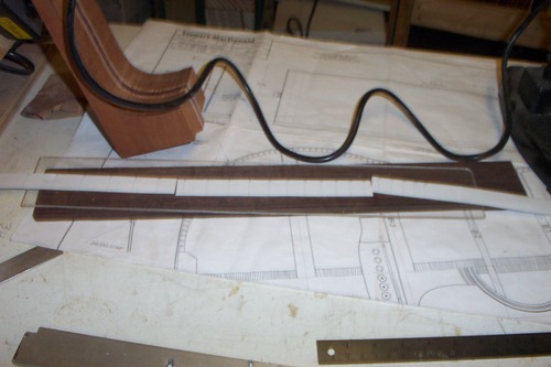

Made myself a template for the fret slots, thanks to Todd Stock and Bruce Dickey for that, it was acurate and easier to do that way!
Here's how the carrier board worked better for me.

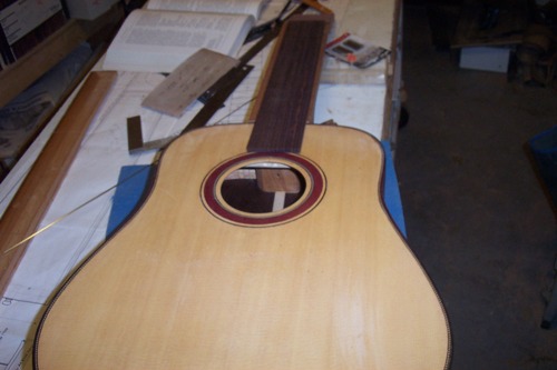

Here's the fretboard completed!

Thanks Todd, yes, i kept a file of Terry's jig also and bought myself a mini drum sander that will either go in my drill press or the hand drill, i really look forward to shape that neck the right way this time! Could you show us a pic of your jig also Todd?
Thanks Dave, yes indeed, it was easier than i thought it would be, Thanks to Shane for that great blade and for the blade stiffners from Lee Valley which help prevent any wobbling(sp?) of the blade. You don't really need a huge table saw for lutherie, just a small contractor saw will do, of course, i'd have a bigger one if i could afford it though!

Looking good Serge. Will you bolt on the neck ala Cumpiano or glue it? Will you finish the neck and body seperately? Will you use a truss rod?Tomas38894.40625

Way to go, Serge! I really like the neck laminates

Hi Thomas, Thanks!

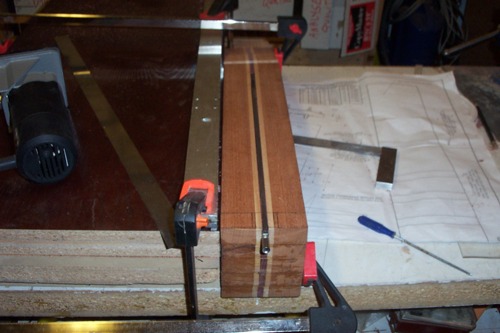

Yes, i will use bolts and inserts a la Cumpiano and also a truss rod, i bougth the stuff from Shane Neifer who is a sponsor here. The neck and body will be finished separately, probably true oil for the neck and french polish for the body. It's hard to see in the first pic but i already did the truss rod channel, here's a better pic!
